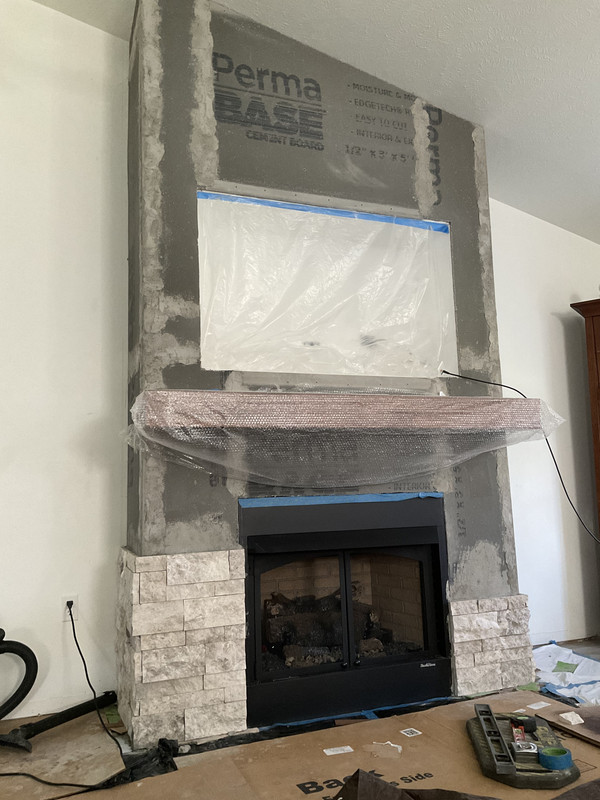

We just finished a fireplace on frame we used cement board and mortar mix. It really depends on what type of faux stone you use. Go by their instructions. My stone was heavy.

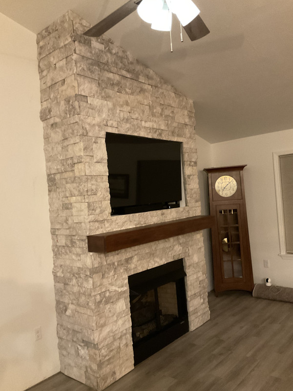

Your fireplace came out very nice. Here is a pic of ours.
