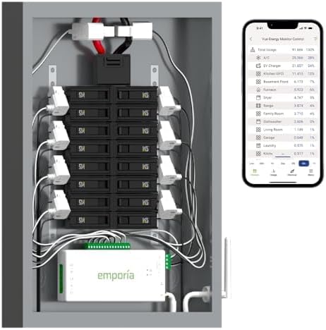

Thinking about one for the house, now that we have the EV's charging, I'd like to be able to see the actual use so I can determine the cost as well as what other devices are using and pct of total bill.
They have smaller system with only 8 modules for $50 less than in the link but I'm thinking, why not have a sensor on each leg or as many as possible.
We have AC, Pool Pump, Dryer, Oven and EV all on 240v circuits, as well as the normal TV's refrigerators (2) the 8 sensor would cover all those and the remaining would just fall into the uncategorized area.

My EV Charger that we have came with the car and doesn't have any reporting, it is a GM model and yes GM's charging platform information is non existent, as are the controls you can get in the aftermarket. So $400 for a new charger that supplies data, or, $200 for the top data information system from Emporia,
I could go for the lower cost unit at $99 but that monitors 4 stations which would cover EV, AC, Pool, Oven or Dryer.

Power bills here in FL are always going up we'll see $200 in the winter and $600 in the summer.
Have a Nest Thermostat, all LED bulbs, the range is gas as is the water heater and it's on demand, pool pump is a Variable speed with timers set to reduce the speed just to circulate water, two years ago we increased the insulation in the attic and none of it is keeping up with the price increases.
Or maybe it is just keeping us from going even higher...
Having data for this summer knowing where the power is going exactly vs "well it's summer so it's your AC" doesn't help me plan for upgrades.
Tossing $15K at a 21 Seer heat pump, or $50K at all new windows, $70K at Solar without data knowing what is needed and where to make changes isn't prudent.
Lets say we find out that the garage fridge in the summer is working double time, or the AC, which is a 12 seer is 50% of power, knowing that then you could perhaps justify a higher seer AC unit.
Thinking the smaller unit is ecologically sound as it would cover the 240 use easily, and I might find the pool pump is a problem as the wifes always going to turn up the speed so the fountains are on and grandkids in the pool all summer..
Point is I have no clue what's really driving the bill and want specifics... I've read where people have found power savings after discovering things running and using a lot of power they didn't think was a culprit or, where they could save money.
Theres is also a brand called Meross that makes this, so curious if anyone has that brand vs Emporia.
Link Meross Energy Monitor

My Advice: Don't put cheap Chinese shit in your breaker box. Especially shit that requires some other wire to leave your breaker box to power it. Does that even conform with NEC?
there are other ways to measure power, outside of your breaker box.
The inside of your breaker box needs to be as clean as an operating table.

I have been using the Emporia system with 16 sensors for several years now. It works very well. Data has been consistent with my utility bill. Since I have a well for water, it has even helped detect a leaking toilet that caused the well-pump to cycle in the middle of the night. I was able to install it myself - but I have enough experience to work inside the breaker box and know what not to touch. No wiring outside of the breaker box - just the antenna that connects through a knockout.
