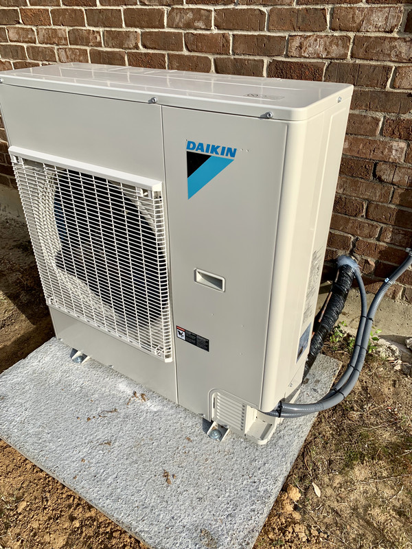

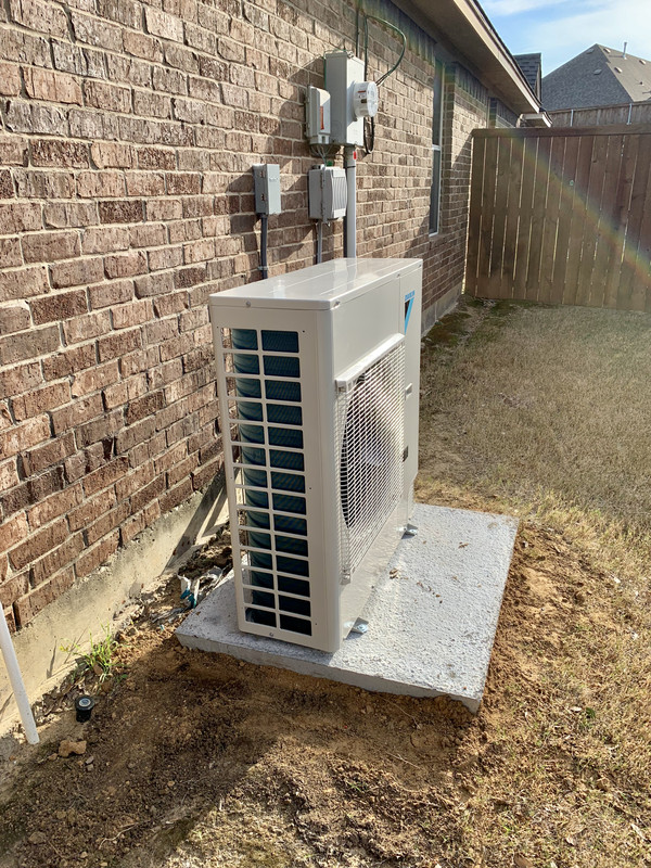

So here’s the new system, most of it anyway. The gas furnace / air handler thing looks like, well...a furnace. I didn’t go back in the attic for photos of it. The outside unit is what is impressive to me. It’s less than 1/2 the size of the old unit and is a 4 ton, 18 seer system. It’s made by Daikin and called a “Fit”. The system is not one or two stage, but infinitely variable. Lots of electronics that scare me, of course there’s the WiFi thermostat. It controls humidity levels as well on the app or thermostat. If it all didn’t have a 16 year parts AND labor warranty, I would have been too scared and probably just put a more traditional setup in. They got here at 8:45 this AM and were done by 1:30. FYI, our house is in the DFW, TX area and is about 1900sq ft.

That compressor looks more like the ones Daikin pairs with their mini-splits. That thing is tiny for a 4 ton unit. How quiet is it when its running at top speed?

It’s crazy quiet. You actually can’t tell it’s runing unless your right beside it.
