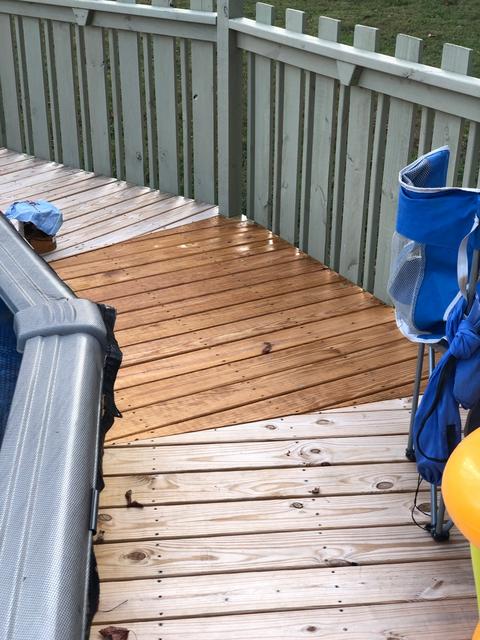

Update:
So I went with TWP oil based stain, the lightest premixed color they have, Honey Tone" after consulting with member "cusingeorge" and he helped me find a vendor for it. It looks great, and soaked in like a sponge. One coat for now, likely a 2nd next spring. Not glossy, but that would be slippery when wet so it's better it is not.
Testing it in one section...
Posts: 4493 | Location: Middle Tennessee | Registered: February 07, 2013Reply With QuoteReport This Post

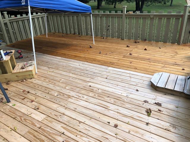

Picture of cparktd
Deck is not complete but close.
