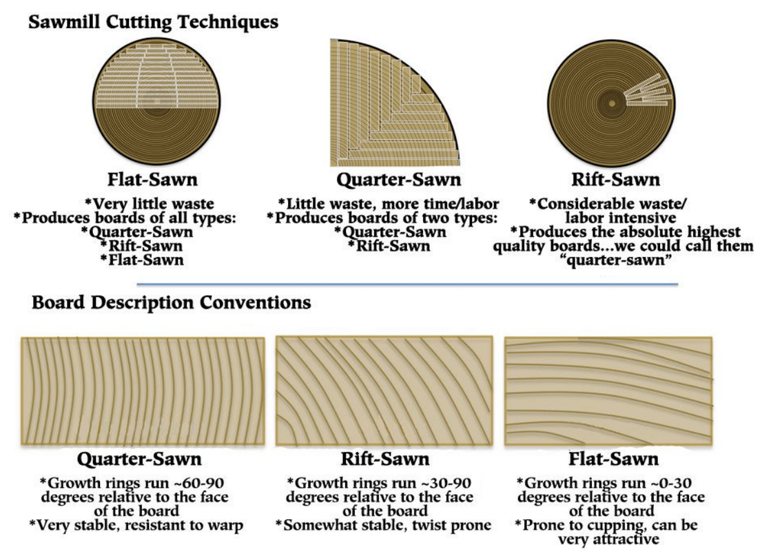

The distinction is the way the grain runs when the boards are cut from a log. Cutting quartersawn planks is more work and there is more waste (you get fewer boards out of the same log) than with plainsawn/flatsawn, so quartersawn boards are significantly more expensive.
Random image from the web:
Quartersawn wood is much less likely to cup or warp and are just generally more dimensionally stable with the moisture changes that happen with humidity changes.
If you're gluing a bunch of boards together side-by-side, that really matters - a butcher block made with flatsawn grain orientation can tear itself apart from the stresses of boards cyclically warping in different directions with moisture changes, or can badly warp across the entire assembly if a number of boards cup or warp the same direction.
If you really want something not to warp or twist - like a guitar neck, for example - quartersawn is definitely the way to go.
In most woods, there are not meaningful strength or stiffness differences between quartersawn and flatsawn boards, and what differences exist have to do with loads that try to bend the board, not loads along the length of the board like you have with wall studs (a warped board will be less strong in the sense that it will buckle more easily, but that is not relevant in house framing).
There could be a small difference in strength for floor joists and rafters and stuff, but house framing is HUGELY stronger than the actual loads involved (excepting stuff like tornados and earthquakes) and the strength limitations have more to do with how the boards are attached to each other than the strength of the boards themselves.
So fundamentally, no, for house framing, there is no meaningful strength benefit.
Quartersawn would by more pleasant to actually do the framing with, because you wouldn't have to deal with a bunch of warped boards, but the end product would not be meaningfully stronger.
