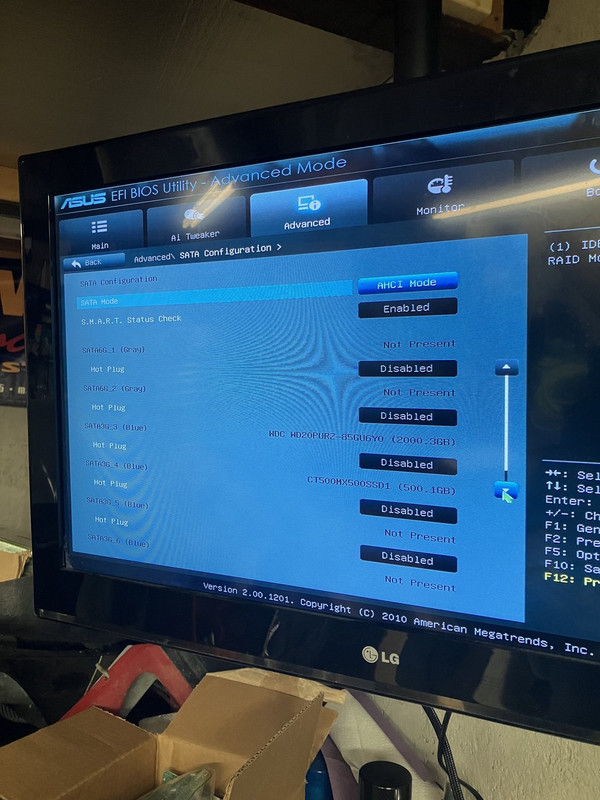

Enter BIOS. Check under the miscellaneous section for the AHCI settings. Both drives should be listed.

In the BIOS both are listed as bootable options with the SSD chosen as the boot drive.
In the AHCI settings they are both visible as well but both show their hot plug (no clue what that means) is disabled.

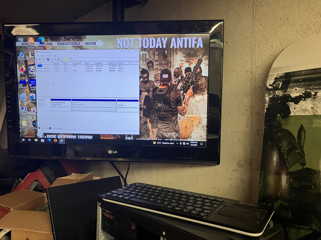

BIOS is clearly seeing the drive I see it on the SATA drive options and it moves ports every time I move the cable to a different port. I can boot from it choosing it in the BIOS.
But when I start the computer and open disk management in Windows it is not there.

Does it show up in Device Manager?
