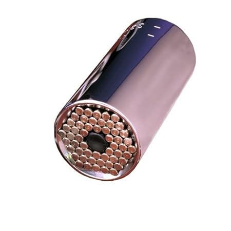

When I had my small engine shop, I used a gator grip socket. Worked every time. Everyone should have one in their tool box.
https://www.amazon.com/Profess...cation/dp/B00008K2TF
