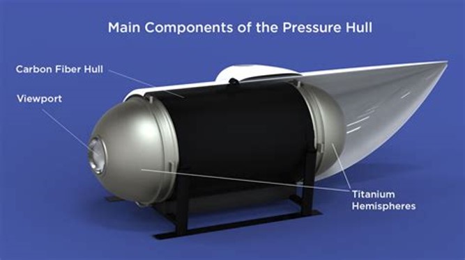

sdy
i still struggle to understand the design, but these 2 pics from oceangate.com help
don't know why it looks blue thru the viewport, was just interested in capturing where the bolts were
June 28, 2023, 09:06 PM
ArtieS
The blue window is a reflection of the blue of the water column.

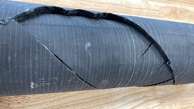

Maybe the shattering thing is temperature dependent. Here’s a picture of a failed carbon fiber composite pressure hull:
"This is the carbon fiber pressure vessel following its implosion test, showing the delamination of its walls.” Link
Not shattered into a billion pieces.
