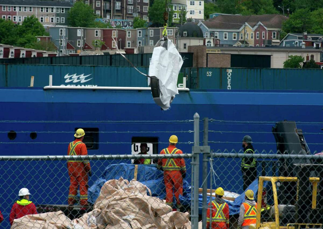

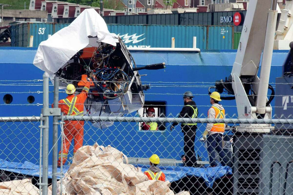

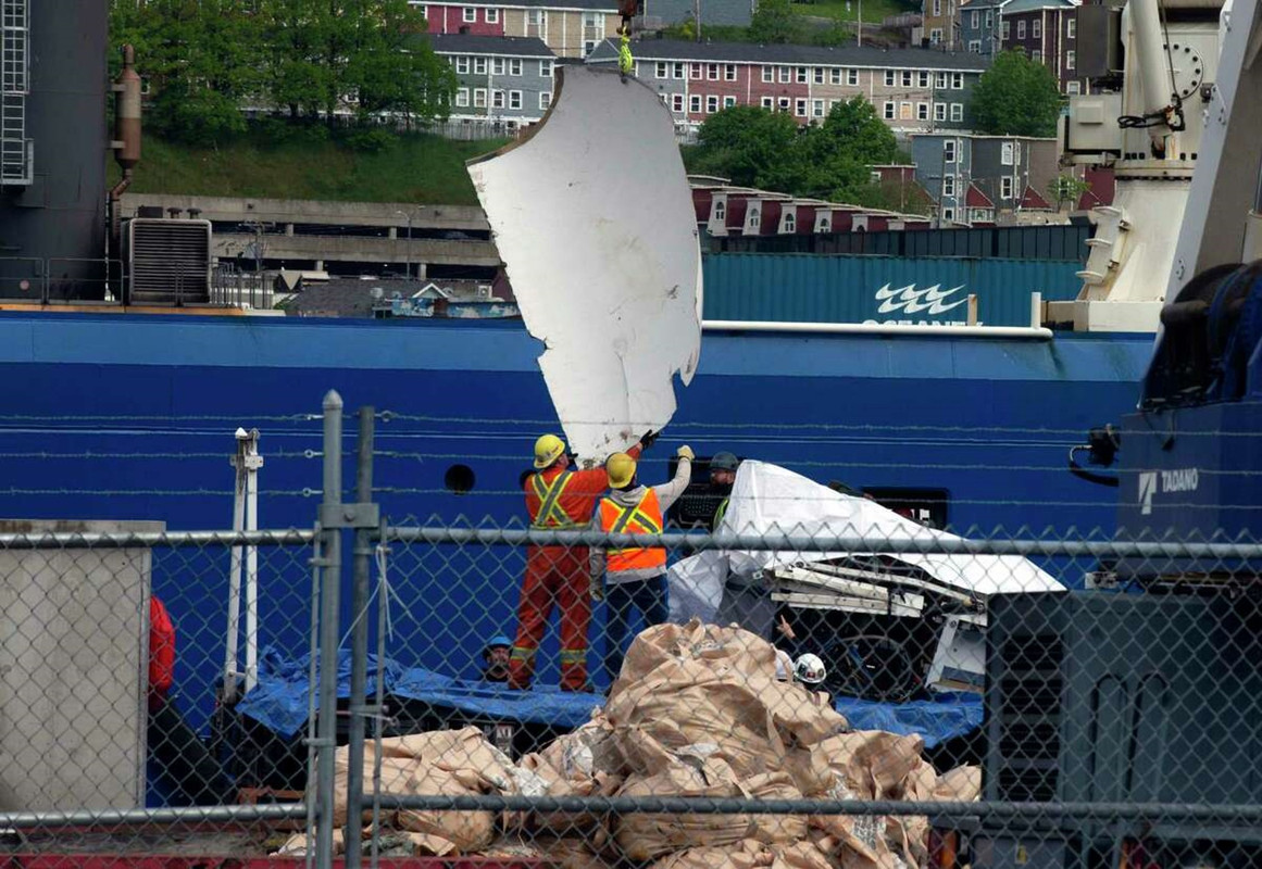

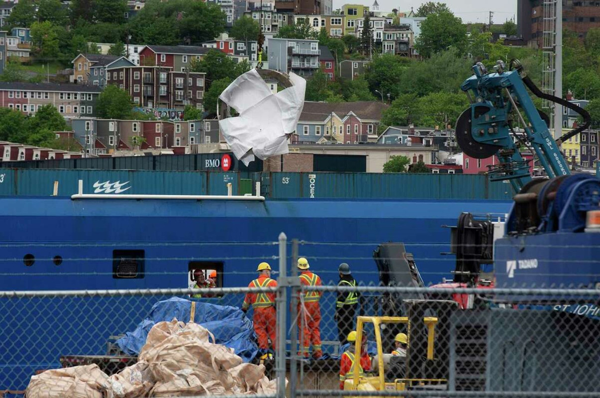

Photos from the wharf show what appear to be several pieces of the submersible being lifted from the ship, including the nose cone with its distinctive circular window.
Given what we've read about the probable violence of the implosion, I'm honestly surprised any of the carbon fiber pieces of those sizes remained.
I am not an intelligence officer but those pictures look to me like the equipment that is housed outside the pressure vessel under that aluminum (?) fairing material. Ie, the stuff that sheaths the outside of the vessel and makes the “tail” stern shape. Ie, not CF.
Two of the pictures above look like different angles of one the titanium rings that were glued on each end of the carbon fiber tube. Looks to be in good shape, round. None of the rest of the pictures appear to be the carbon fiber tube, but maybe parts of it are in the small bag?
None of the pictures show the end caps either. Not the ones posted above and not the ones in the linked article. The viewport was 1/3 the diameter of the end cap. The end caps were attached to the rings that were glued to the tube.

I’m not certain any of those carbon fiber pieces are from the pressure hull. They appear to be from parts of the tail cone-which I surmise would not have been pressurized, and maybe not carbon fiber. It seems like only the titanium end caps, and the non-pressurized portions remain. It’s unclear to me if the viewing port is intact, but it still looked to be in place-if not intact.
Posts: 3274 | Location: (Occupied) Northern Minnesota | Registered: June 24, 2003Reply With QuoteReport This Post
Those titanium pieces look like the end “rings” that were glued to the CF tube. None of those pictures seem to show the titanium “domes” that one of which would have the view port. I see nothing like those domes or viewports in any of the posted pics. I couldn’t get the link to open so if there are more pics there I did not see them.

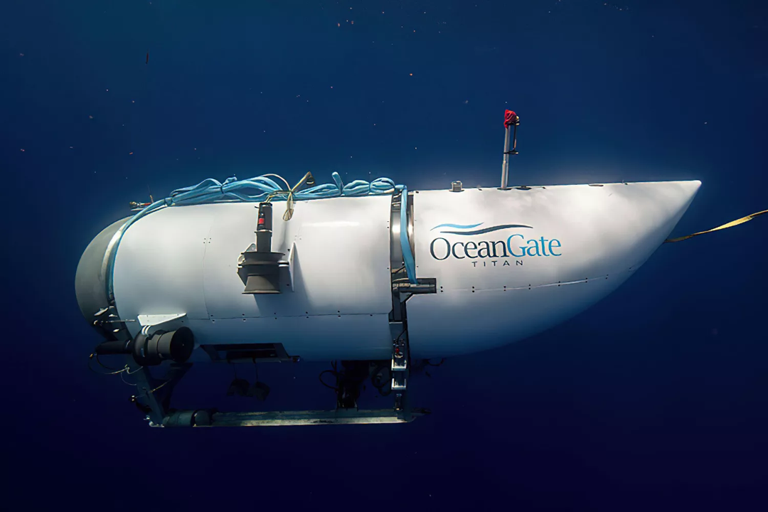

Nice picture but am I missing something? In that pic you can see, front to back, viewport-titanium dome-titanium ring-CF tube-titanium ring-hidden titanium dome-hidden “avionics” bay behind fairing. What else?
None of the first pics appear to show any “domes” hence no viewport either. Clearly the titanium rings and domes didn't stay together, 17 bolts notwithstanding.
