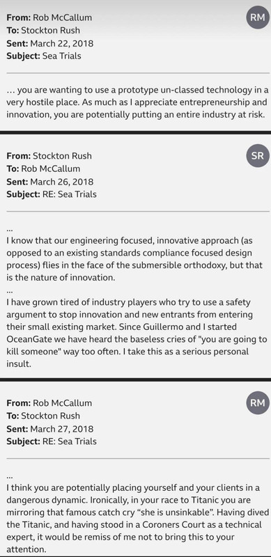

That is one hell of a way to be proven wrong. When a lot of experts tell you the path you're on will get you or others killed, you ignore them at your own peril, and likely at others if you do it as a commercial venture.
If you can't build it to the recognized standards because you think it costs too much, then go find something else to build.
I hope this gives anyone else starting down or on a similar path serious pause.

That text thread makes that one dude sound like Nostradamus. Either way, interesting topic and gonna be a great movie.
I guess he won't be tired of people telling him he is going to kill someone anymore. If a bunch of people tell you that, maybe just maybe, you should reassess.
