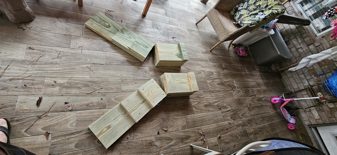

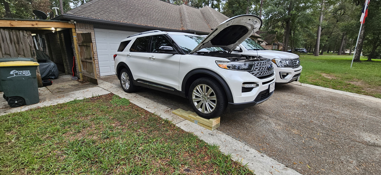

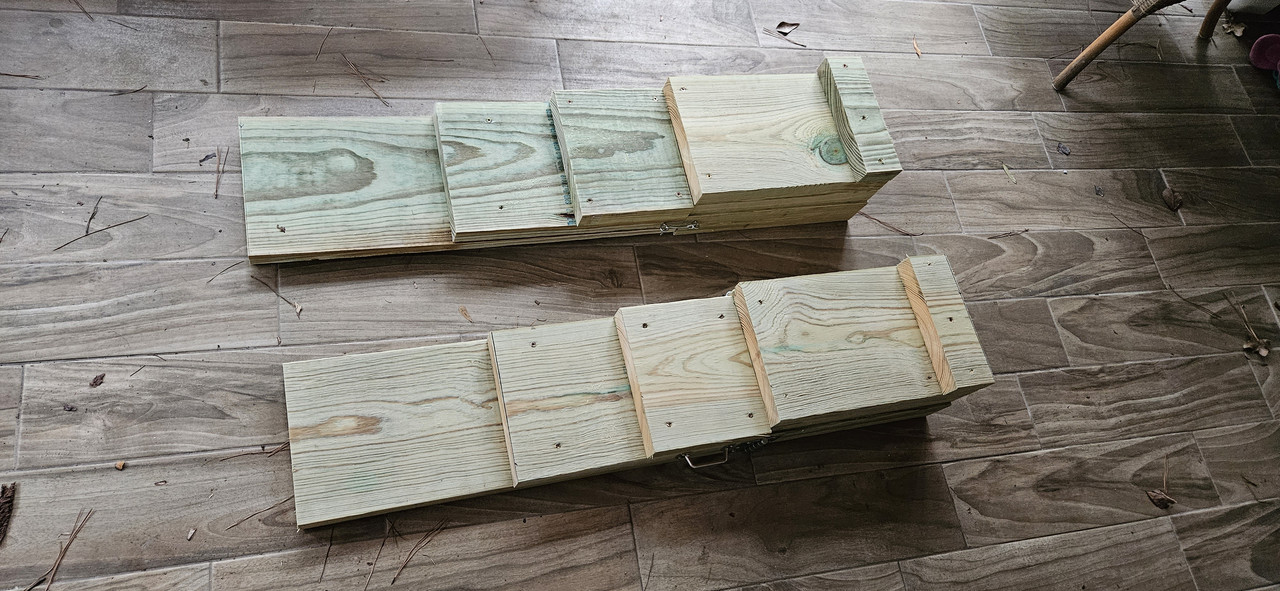

Temporary solution. Happened to a video pop up in my YouTube feed for building these. About $50 in materials, since I went with 2x10 instead of the 2x8 the video recommended.
Handy with being hinged so you still have side access if needed.
Other than nearly driving off the end [a spotter would be a good idea], they worked great. High enough to roll under with a creeper & get the oil changed.
Couple thousand miles & I'll get to try them with the Expedition, too.

Mine's the 2.3
Filter is a spin on, on the bottom, right next to the oil pan, luckily.
The Hulk's roided out 3rd cousin must've transferred to the dealer where I bought this one. Both the drain plug & filter were obscenely tight. Wish I'd thought ahead to order a Fumoto for it.

I went with a wider board & also added a grab/carry handle to the side. 275 width tires wouldn't be ideal on an 8in board.

I was going to do 2x12, but the lumber cost would've doubled.
2x10 were around 15/board. 2x12 were a bit over $30 @ HomeDepot
