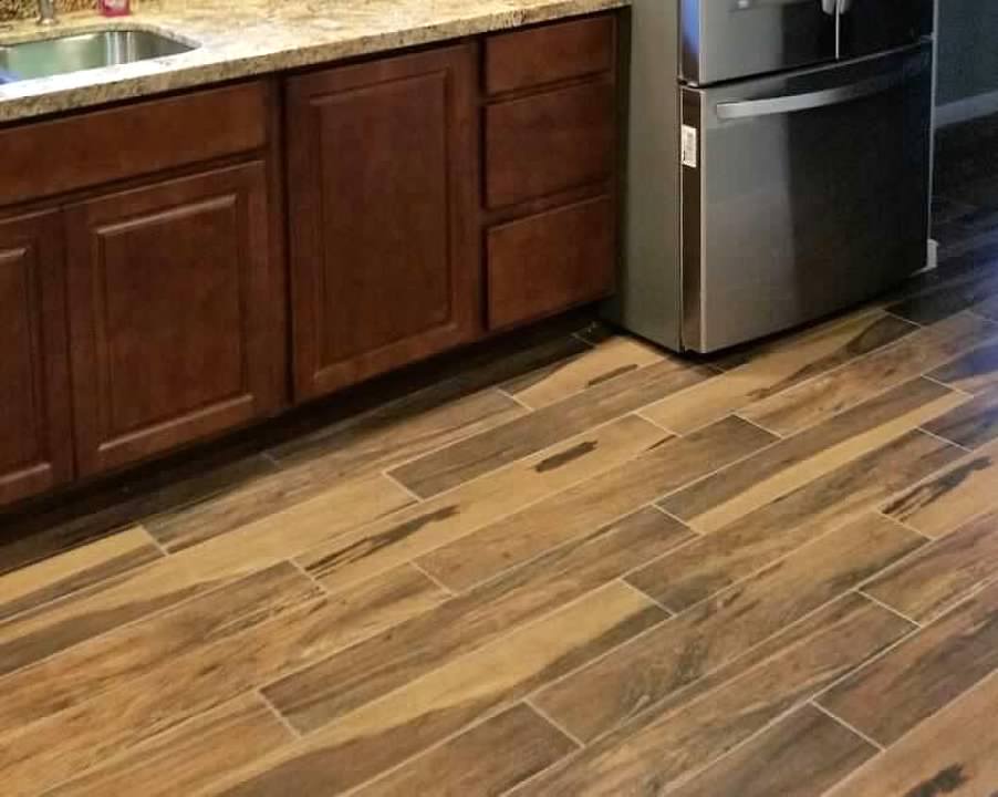

We installed porcelain "genuine imitation wood grain tile" throughout the house. We chose Brazilian rosewood pattern and couldn't be more happy with it.
