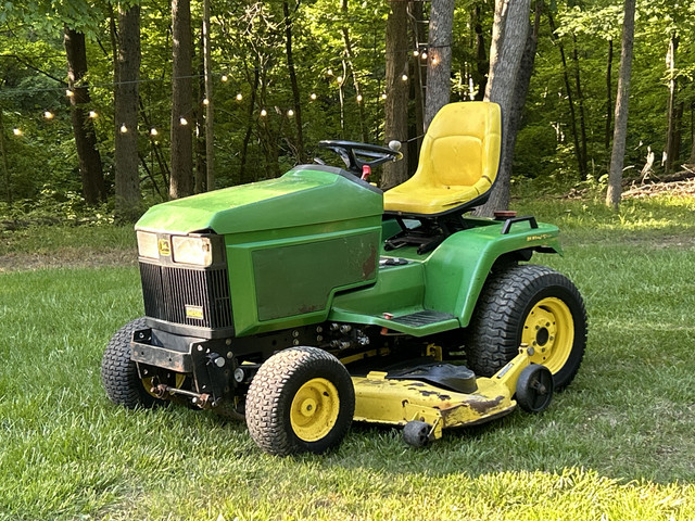

MACHINE PURCHASED!
My neighbor was selling his JD 445 AWS and gave me a killer deal. He even threw in a JD pull behind leaf broom. $1200 delivered.
The 54” deck is a noticeable improvement to my current 48” deck. The AWS is amazing and the linkage is tight. The Yanmar diesel is solid and strong. The locking rear diff has already pulled a stump for me. It’s over 1100# with the current deck. I’m planning on adding front wheel weights for the inclines. But as it stands this thing is very solid with all the weight low.
No, it’s not a compact tractor but it will bridge the gap until I can afford. I really wanted the ground clearance of a 4110 but the price difference is huge. I don’t have a trailer to fit anything bigger than this too, so, it came home. This will be enough until I can afford something with a loader.
Luckily my neighbor is a traveling heavy mechanic and this has been his wife’s mower when he usually uses his 3 series. It’s solid mechanically but needs some cosmetic TLC. It needs the typical replacement body panels for the 4X5 series and some tires. I am going to rebuild the deck at the end of the season and address the rust then. There is a small hydraulic leak. But, I’m looking forward to the project.
This is my first diesel and will be running year round with clearing the lane.
Any tips for not running into issues with diesel in the different seasons?
Posts: 116 | Location: Deep in the fields  | Registered: July 16, 2025Reply With QuoteReport This Post

NICE! and you flat stole it at that price. VERY nice neighbor.
Things to watch for if you're not used to diesels:
1. Fuel. Diesel fuel doesn't do cold. It'll gel and ruin your entire day. If you're in cold country, get in the habit of running fuel conditioner. Pump fuel from the station is treated seasonally, but I always add conditioner both to prevent gelling and to combat algae growth. On the same subject, change the fuel filter regularly.
2. Cold weather starting. What constitutes "cold" varies from engine to engine, but in general, below 50°F it's a good idea to use the glow plugs.
3. Diesels use different oil and coolant than gas engines. Use diesel-rated for both.
4. AVOID RUNNING IT OUT OF FUEL! It's not a total disaster, but it IS a pain in the ass, requiring the system to be bled before it will restart.
That Yanmar diesel is a beast. I had one in my John Deere 750 for 28 years and never put a nickel into it outside fluids and filters.

Yea, an older JD with a diesel is another animal than one with a gas engine. You did good. It should serve you well.

Thanks for the tips and kind words.
I figured that even after budgeting $500-1,000 for service and cosmetics it would be worth it.
I’m going to get it set up to push snow this winter unless I can find a thrower.
Are any diesel fuel additives (stabilizers not octane boosters) worth the money? I always use Stabilizer with my gas for equipment.
I got the JD leaf sweeper cleaned up. All it needs is some new brushes and a little massaging with a lead hammer.

Did a full service on it and things look good.
Some mouse had made a nest in the dirty air intake so that and new air filters made for noticeable increase in power. The valve on the intake was missing so it made a nice little nest.
The other filters were all newer and the hydro fluid was clean. Some water in the fuel filter but it had been sitting. The Yanmar 3 cylinder is easy to work on.
The tranny needs to commonly failed seals. Very common and easy to address.
New Carlise tires up front. It’s the AWS version so I going to have to do an alignment and tighten up the tie rods.
Got lucky and the body work only needed a new hood at $98 delivered from eBay.
The decals are about the same amount sooooo…pass on those.
I’m going to upgrade the headlights with some basic 12V headlights from NAPA. The factory lens are toasted and I will need the light come winter.
