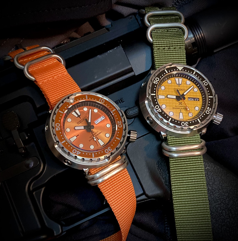

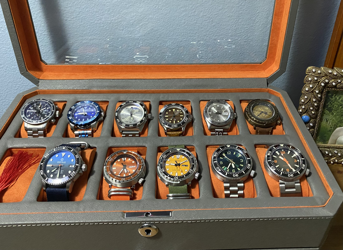

The Ice Cream Man
Has anyone tried swapping a Seiko into one of the Ti cases on eBay?
I’d like. Ti turtle or Willard, and it seems like the only way to get one.
If it’s possible, I’d probably hire a local watchmaker to do it, actually.
All of these except the Fortis on the top left and the Deep Blue on the bottom left.
Parts from Ali express, Namoki Mods and eBay. Tools from kind of all over.
No idea where the patience came from!
I like the fact that you can pick dial colors and cases the way you want, not just what Seiko ever came up with. Both the above were eBay dial finds, the bright orange listed as from a Nemo, but I love it in the Tuna case.
This one was a total parts build, I think everything came from aliexpress. It’s huge, and heavy, and utterly cool in my oh so humble opinion…
Last but not least…
Seiko movement, a bronze Tuna style case from eBay I think, and the dial is from a 1900s pocket watch.
Not going to find anything like that for sale, at least not that I’ve found.
So, yeah, I say go for it! It’s a learning curve, but definitely fun.
And yup, like so many other reasons my budget keeps screaming at me, this hobby started here, in the Watch Photo thread!

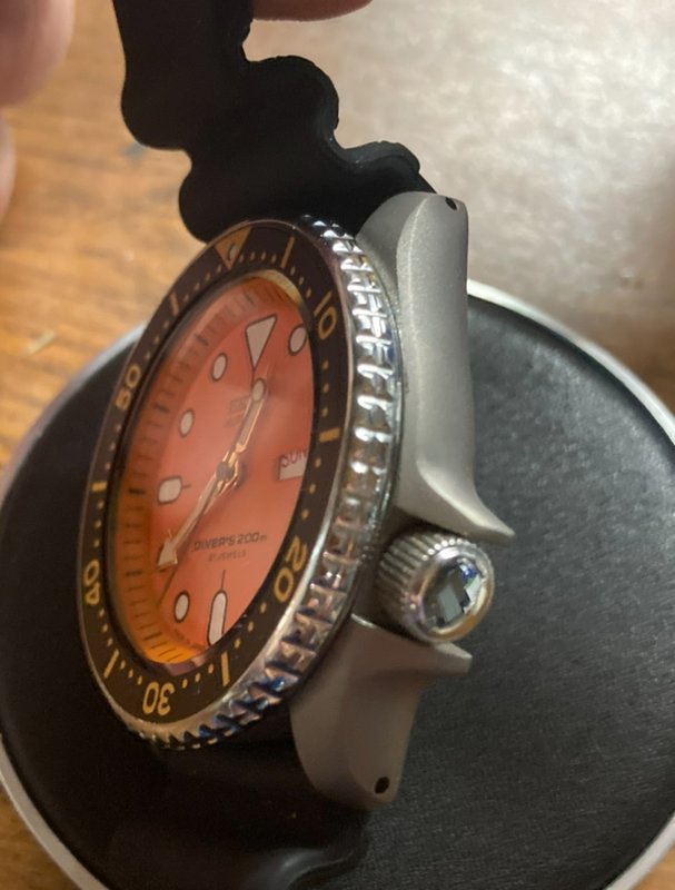

I’ve done it with a Seiko SKX011J1. Titanium is SUCH A SWEET mod to do! It is so lightweight! Even on something as small as a watch case you notice the difference.
Here it is before swapping out the Ti bezel for an OEM Seiko bezel/insert.
I’ll post up a pick of a stock SKX011J1 next to my Ti swapped SKX011J1 when I get off work.
