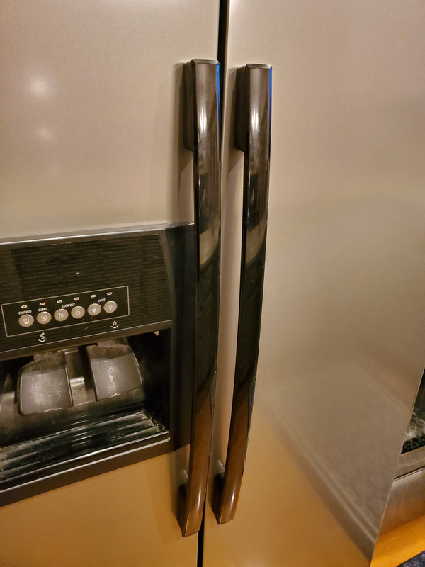

One of the handles on our fridge is starting to come loose. Looking at the handle I can see no way to get to the screws. Any idea how to tighten this up? This is a whirlpool fridge, by the way.

There is probably an allen key on the inside face of each end of the handle. Look closely, you can probably just snug them and be done.

No screws on these handles. After playing around with it, we found that the handles slide up and off, revealing a mounting clip, which we tightened.

On ours, the allens are set screws that secure the handle to a plate (under the handle) that is held on by other screws. Tightening the Allen screws did no good. What fixed the problem was loosening the Allen screws, taking the handle off, tightening the screws holding the plates to the door, then replacing the handle and tightening the Allen screws. YMMV
