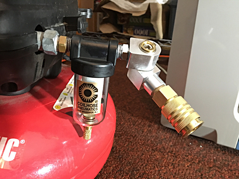

Recently acquired a brad nailer. That'd make my fourth air tool. I thought it about time to look at conditioning my air.
Lowe's has a Kobalt brand in-line filter that gets good reviews. But the thing would stick way out the side of my pancake compressor, just begging to be kicked, stepped-on, bashed into something, have something dropped onto it, etc. So I bought a 360° swivel and a pair of fittings. Put it all together.
Drain valve leaked air like a sieve. Back it went for an exchange.
Now couldn't get the connection between the new filter and the swivel to be air-tight. This is far from my first air fitting rodeo. Upon inspection it looks like inferior materials that didn't stand up to a couple tightenings. Meanwhile I've raggedy old fittings that have been re-used several times and seal just fine.
So it's all going back and no more Kobalt air fittings or accessories for me.

Yeah. I'm thinking of giving it One. More. Go. with a Milton 360° swivel from my favourite tool store.

I've now got a Milton 360° swivel and a Coilhose filter. Going to try that combination today. We shall see. Wish me luck.

It's those pipe threads on the fittings, and most threaded pipe these days. The O.D. are too small and the I.D.'s are too big mostly from china. In the past about 1.5 -2 turns of Teflon tape did the trick, but now you need about 4 turns to get a seal. Just imported junk.
Try an army /navy surplus store to find good air fittings and quick disconnect fittings that work and won't leak.

Got it!
Drain just >< clears the tank. Had to screw it nearly all the way in (open) to clear the tank while turning it on.
I don't like that the whole assembly sticks out that far. Hope the metal on that Coilhose filter is good and strong.
Yup, Teflon tape.
Sometimes you just have to fend for yourself and fix things even things that you shouldn't have to fix.
