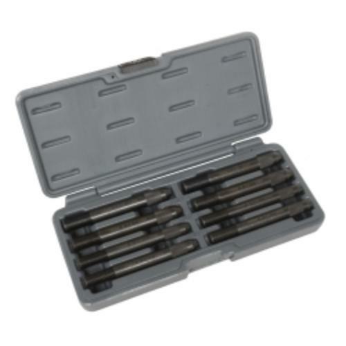

These suck no matter how many pieces they are made from. Roll Eyes The wheel likes to fall off when you remove the last bolt, and the bolts are difficult to start while holding the wheel positioned when putting it back on. Why the European cars (remember who designed your Jeep) all do this, I haven't been able to find out. Pilot studs …
… make this easier. Take out two bolts across from each other, leaving the others in for the moment, run in the appropriate pilot, then take out the rest of the bolts. Now your wheel doesn't fall off. When putting the wheel back on, slide it over the pilots first, start and lightly run in the bolts, then take out the pilots and start the last two.
