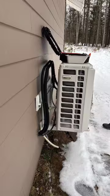

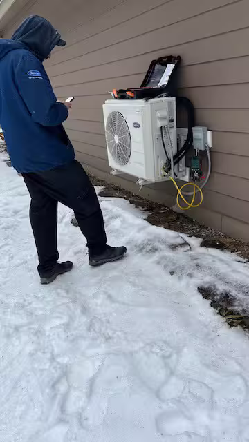

The serviceman came today as scheduled and at 40* outside is warm enough to thaw most of the ice out and run the unit.
The heat element in the bottom is functioning correctly.
There is sufficient charge as it's putting out very warm air inside (I forget the temperature he said it was).
He feels the problem is it was installed with a long vertical loop in the lines. From inside where it's mounted near the ceiling the lines fed down the wall, exiting at floor level to outside, then back up 3' before going horizontal behind the unit and turning down again to circle and enter the right side of the unit. That 3' rise is too much and it has created a 3' high trap which can allow oil to accumulate in cold conditions. The result of this is similar to being low on refrigerant.
Service call was $95. The cost to come back and re-route the line eliminating the trap effect would be $725.
They installed the unit as well as repaired it when it froze up that first winter under warranty not noticing the line loop trap at the time. They claim that Carrier installation instructions back in 2019 did not specify that lines could not run down then back up but more recent instructions do after they realized it could create a problem.

Originally posted by ridewv:
Thanks for the explanation sigmonkey....
Glad they did you right!
Understanding the "P" trap issue was a thing I learned back in the early 90s.
Line sets should be run to ensure oil returns to the compressor both in heating and cooling (Heat pump) operation, and not collect in the line set and create "traps" of oil.
Posts: 46461 | Location: Box 1663 Santa Fe, New Mexico | Registered: December 20, 2008Reply With QuoteReport This Post

When I built I considered putting a chimney and wood stove in but decided against it for three reasons. One, I have motorcycles in the shop and there could be the chance of a gasoline leak. Two, I didn't want to give up the space a wood stove, including setback, requires. Three, it would still require a heat source for when I'm not there to feed the stove.
My house is heated with wood when I'm home and it's below 35 or so, otherwise it uses a heat pump as well. Unlike the mini split though it has resistance for back up or when below 25.
They're actually out there right now redoing the line. They called me back last week saying "forget the $725 we're just going to fix it for you". I thought that was nice of them!
