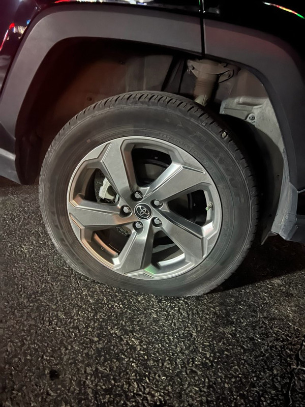

First pic below shows the low tire.

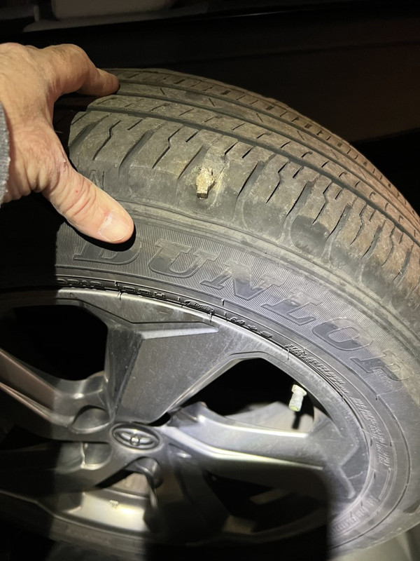

Second pic shows the punctured tire. It's right at the edge of the tread and sidewall, so not repairable. I knew this as soon as I saw it.

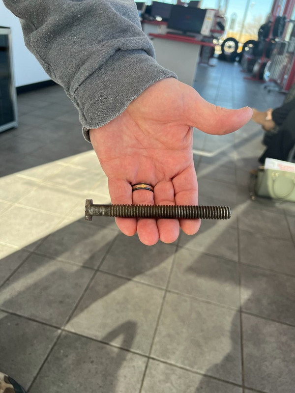

Third pic shows what was pulled out of the tire. Based on the size of this thing, even if it would have penetrated the tire in the center of tread, I don't know if it would have been repairable.

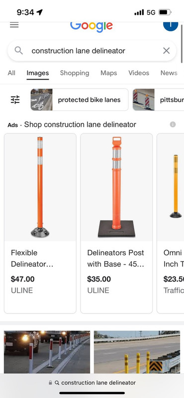

Fourth pic shows what I think it was. Best guess, there was a second lane delineator, and it was hit before I got there and the orange part stripped off, leaving the base and the threaded piece that holds the reflective pillar to the base. I think Iran over this.

That is quite the bolt! I think I had two last Summer, a small nail then a screw.

That looks like a rear air brake cage bolt, dump truck dropped it.
Be glad it didn't take out your rim
Posts: 6956 | Location: GA | Registered: September 23, 2009Reply With QuoteReport This Post
safe & sound
Picture of a1abdj
That's exactly what that is.

13 minutes to get an answer to what it is, and I didn't even ask the question! What a knowledge base this place is!

BigSwede beat me to it. As soon as I saw it, I immediately recognized a cage bolt off of a big truck air can. In fact, just yesterday I was laying under a truck, installing four of them on a trailer that had snapped off a glad hand.
They are carried in a little holder on the side of every air brake chamber (with parking brakes) to release the brakes in case air is unavailable.
You can see where it is carried on the side of the chamber.
