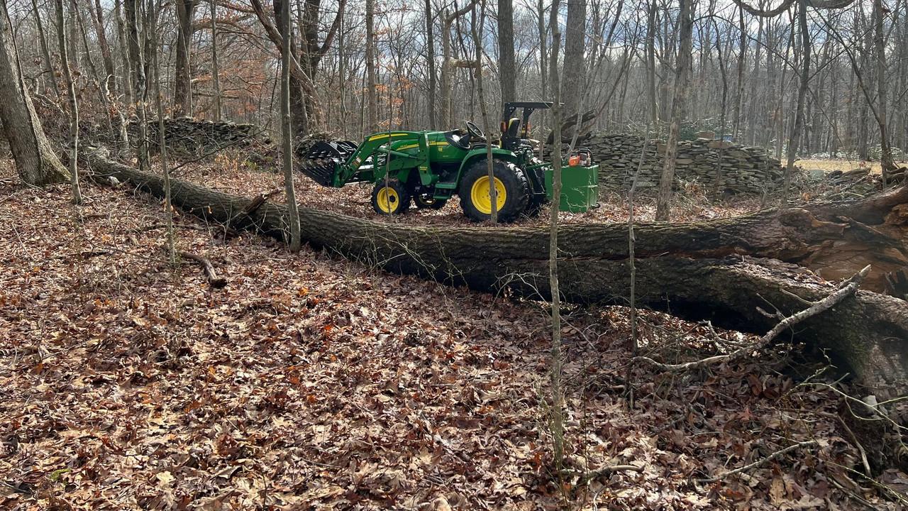

An oak came down right near a trail so I went for the saw and tractor. The original chain on my new saw was finally getting pretty dull so I put on a brand new 20" chain and started cutting in 4' lengths to take to the house to section and split. With that new chain the saw was cutting through oak like it was pine! Then making the next to last cut it touched a rock that was sticking up behind the tree and under leaves, I should have looked closer. But a brand new chain! I had sharp 18" chains back in the garage so I changed bars and finished but still.
