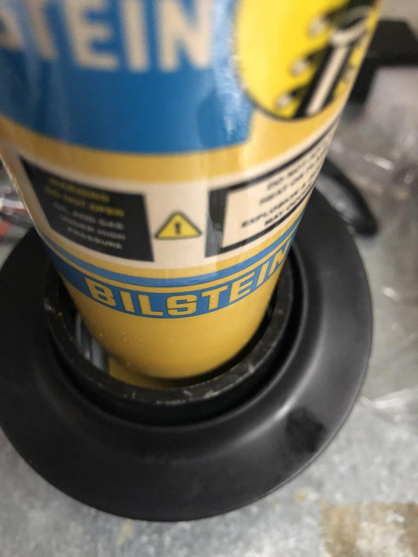

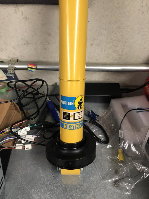

If you can’t tell that black spring perch is supposed to rest on the ring about an inch above the Bilstein logo.
Guess it turns out NAPA uses a larger shock body than OEM and Bilstein.
Expedition rear ends are the same from 2007-2017.
In 2015 Ford decided to start having the spring perch actually attached to the shock body. Prior to that it was removable. Bilstein is the only quality company making shocks for the Expedition. But when Ford made the switch to attached perches Bilstein did not.
I saw that NAPA still utilizes a removable spring perch so I special ordered them (just the perches) assuming the shock body would be the same diameter. Figured for as cheap as they were it was worth the gamble saving me time from deconstructing the factory shocks to remove the perches. Turns out no such luck.
Not a huge deal. Once I pull the OEM shock put it in a vise wrapped in a towel and slowly drill a hole in the body to relieve the pressure then take a reciprocating saw to the body just above the perch and you can remove it to reuse it.
Fortunately this method HAS been done and tested.

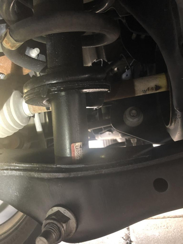

And here was the rant about the fronts.
Apologies for taking so long to get this up after the initial rant about the rears last week. Being short staffed at work has had me picking up extra shifts and out of touch with everything else for the past several days.
I completed the install of the Eibach Pro-Truck Sport shocks on the truck. The fronts have adjustable ride height to level the front end similar to the Bilstein 5100's for the previous generation F-150's. My truck is a 4x4 with the FX-4 package and 3.5 Ecoboost.
First the good, overall I'm happy with the end result. The ride is much more controlled now. The floatiness of the original OEM shocks is gone. With only 15,000 miles the OEM shocks were done. They could be easily compressed by hand and they basically stayed compressed with little no rebound. The bounciness of the rear end is much more controlled. The ride is very firm. Probably a little firmer than the Bilstein 5100's were on my 2013. But that truck was much heavier and it's been over a year since I traded it in so maybe not the most objective observation. Highway ride is great. Driving over the washboarded dirt road that parallels the road to our house, the ride is harsher but the handling is much more composed and controlled. If you like the floaty ride of a 1970's Buick, these are not the shocks to upgrade to.
Ride height is adjustable with a snap ring on the shock body. There are 4 positions for the snap rings. I set mine at the highest level. In retrospect, I would've set them one position down from the highest, but I'm not feeling industrious enough to pull the truck back apart, make the adjustment and then put it back together again. The highest setting does provide slightly more than the advertised 2" of lift in the front. Measurements were taken from the floor to the lip of the fender through the centerline of the wheel.
Right front:
37-1/2" Pre-Install
39-5/8" Post-Install
Left front:
37-1/4" Pre-Install
39-1/2" Post-Install
Now the bad, Installation of these is an absolute PITA. I used to be heavily into autocrossing, so I'm experienced with suspension work. I also installed the Bilstein 5100's on my 2013. With that install the biggest challenge was getting the upper ball joints to separate. With the new truck the upper ball joints came about with just a tap of the hammer.
With the new front suspension design, the lower mount of the shock is two vertical bolts through the lower control arm instead of a single horizontal bolt like my 2013. The bolts are pressed into place and do not separate from the shock body. As a result of the added length to the coil over assembly by the pressed in mounting bolts, there is not enough clearance to remove the OEM coil over unit by just separating the spindle from the upper ball joint. I had to remove the pivot bolts for the lower control arms to remove the coil over units. I supported the knuckle end of the control arm on a floor jack while I did this.
Once I had the springs compressed and the OEM coil overs disassembled, I realized that there were no new spring perches included with the new shocks as shown in the pictures on their website. I called Eibach's technical support and was told that it was not an oversight, that the OEM spring perches had to be removed from the shock body and reused on the new shocks. I told them that the OEM perches appeared to be integral to the shock body. Their response was that the spring perches are press fit onto the shock body and to bang on them with a rubber mallet to separate them. That didn't happen. Separation required a trip to my mechanic's shop, a hydraulic press and a sleeve. In retrospect if I had known, I would've talked to Eibach or located elsewhere new spring perches to use on the install. As it was, I needed to get my truck back together and drivable so the OEM perches were reused.
The rears which should've been simple proved to be a PITA. The shocks are listed for stock ride height as well as 1" lifted. They are longer than OEM, they're also very stiff. The result is a shock body that is significantly longer than the length between the top mounting hole on the frame and the lower mounting hole on the axle. Even with several gyrations of ramps and floor jacks to get the rear suspension at full droop for install, the shocks were still long and required compression to get into place. After various attempts at compressing it with prybars and a floor jack I was able to get the shock in place using a pickle fork. Placing one tine of the fork in the slot of the lower mounting bracket, I was able to get the shaft of the fork underneath the bottom of the shock and then use the handle for leverage. I was able to slide the shock along the shaft of the fork, into place and secured with the mounting bolt. Two shocks and four bolts should not have taken nearly the time that it did.

Yup I am clear on the spring perch removal being a PITA hence the reason I bought the NAPAs hoping they would fit.
I am tempted to take those to a fab shop and see if they can weld in a sleeve.
As for all the other issues you had sure hoping I don’t run into those issues.
I have watched a number of YouTube videos and all seems pretty straight forward. I am planing on using the adjustable 5100s on the front for 2” of lift and 2” spacers on the rear with the 4600.
F150s front work on the Expedition on Bilstein makes a coilover and am tempted to use those.
I have contacted King Suspension to see if they can make an emulsion shock with adjustable lower perch. I can’t afford their full custom coilovers doubtful I can afford just the emulsion shock either but worth a shot.
If not drilling a hole in the shock then lopping the end off with a Sawzall is supposed to get the perch of fairly easily.

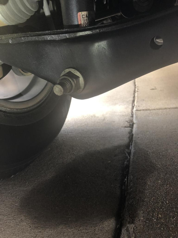

What a nightmare...over something that should be so simple. Since the late 90s, Ford has been king of over-complicating stuff that they don't need to, and sticking stuff where you can't get at it. I naively agreed to help a buddy change the struts on his Taurus one time...I'd just done it on my Impala, and it was a simple straightforward job...unbolt, bolt on, take it out for an alignment. Not so on the Taurus...took about 5 hours and we had to drop the cradle to get everything out and back in properly. And I crushed the tar out of my thumb in the process.
Don't get me wrong...the 00-05 Impala is easily as much of a POS as the contemporary Taurus, but at least you can work on the stupid thing without having to jump through hoops. I've looked at F150s and Expeditions at times over the years, because they're nice trucks, but I've always opted to spend a little more time looking until I find a comparably priced Silverado or Suburban just because I know I'm going to be under the hood either way, and it's frustrating enough fighting with rust, age, and wear without having to fight institutional engineering incompetence as well.
