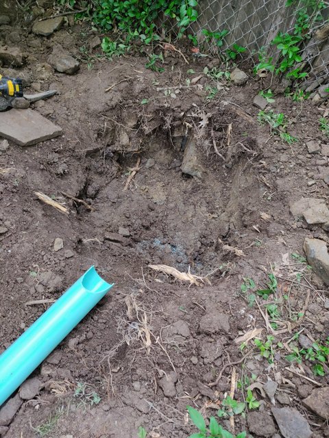

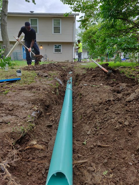

Sorry to hear this, what a pain in the ass. I'd suggest first making sure gutters are cleaned regularly and second installing a pipe underground to route the water away from the house. I did the later a few years ago and added a dry well and an additional clean out/drain halfway through the piping in a spot that collected water in heavy rains. No more water near my house and a less soggy backyard in general.
I made the dry well from old 5 gallon water bottles with holes drilled it them, filled the hole with gravel and topped it with rocks that I had dug up over the years.
