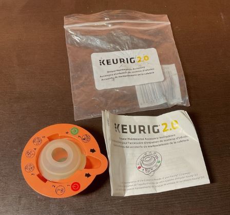

They usually come with a device you fill with a couple ounces of water, then insert in the pod holder and raise/lower to flush out grounds.
I found mine did that periodically, so I used the cleaner and it works fine after.

These things (sometimes) have a problem with the water pressure in the pod/K-Cup, forcing grounds under pressure into the top "(vampire) tap where the heated water enters the pod.
I posted the solution earlier.
Sometimes just running a cycle dispensing hot water is enough, but the little "orange cleaning pod" works every time.
It is basically a "bulb" that you fill with water, insert like a pod, then cycle the lid open and closed, then it should be fine. If not, then you have other issues.
You can keep throwing vinegar at it and cussing, or try the solution Keurig supplied. Mine came with the cleaner thing.
