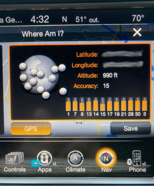

On our way back from doing some shopping my wife and I stopped by a highly-rated local car audio place. Talked to them about a Pioneer DMH-W4660NEX + Maestro RR. He'll call me when the Pioneer becomes available.
Driving away from the place: "I wonder if it's working again?" my wife wondered aloud, reaching for the Uconnect NAV button. "It's not," I replied, "I've checked several times."
She hits the button, I tap "View Map" and... lo and behold: The flippin' thing is working again!
Now what? On the one hand I'd like to be happy. (I must be one of the few people on the planet that actually likes Uconnect.) OTOH: It's probably safe to assume it's going to go tits up again, someday.

Since it’s now working I’m going to assume that it’s RoHS compliant solder and poor contact somewhere inside.
Probably. Since it failed during a fairly extreme cold snap, and today, when it hit 51°F, it magically started working again, I suspect a temperature-sensitive solder joint.
It's supposed to get fairly cold again. Though not quite as cold as earlier. Perhaps we shall see.
