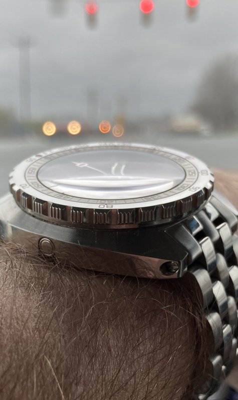

My 44 year old Seiko, rated at 150 Meters, is still chugging along.
It's only been down to 110 feet, though.
Mine has a helium release valve. If it is ever needed, I sure as hell won"t be wearing it!
Tim
"Dead Midgets Handled With No Questions Asked"
Posts: 727 | Registered: March 17, 2007Reply With QuoteReport This Post

I know nothing about expensive watches (I wear Movados), or the topic being discussed. Just wanted to say your watch is beautiful.

Thanks, Skins! I think so too!
Tim
