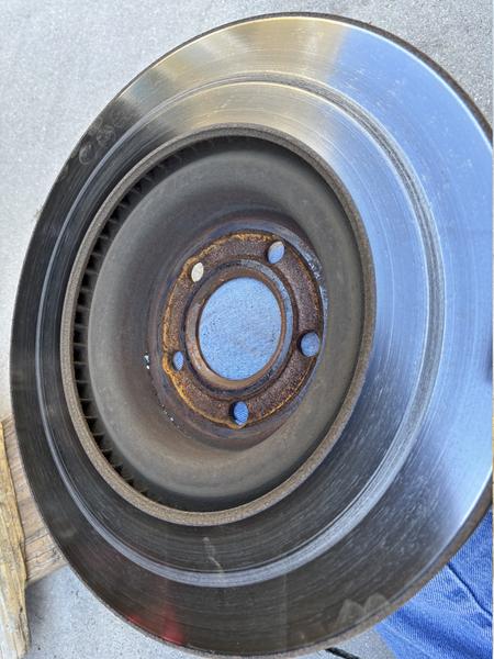

Well let me check my book of funny noises. I keep it on my bookshelf next to my book of silly walks.
Ah, here it is, Chapter 3, page 12:
Thank you Ford Chicago Assembly Plant for keeping me busy.
So proud!

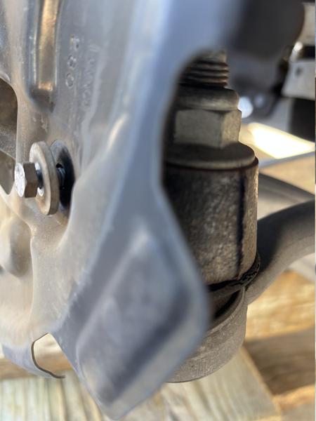

Lose backing plate bolt gouged the brake disc?
That had to be making a lot of noise.

Crazy loud, like rusted, busted exhaust dragging on the pavement, but nothing underneath was out of place. The bad part was the noise stopped for a day, so I figured it was a piece of gravel or something caught between the shield and rotor that had worked itself out. My wife made it 90 miles to Tampa before it started up again.
Posts: 15075 | Location: SWFL | Registered: October 10, 2007Reply With QuoteReport This Post
