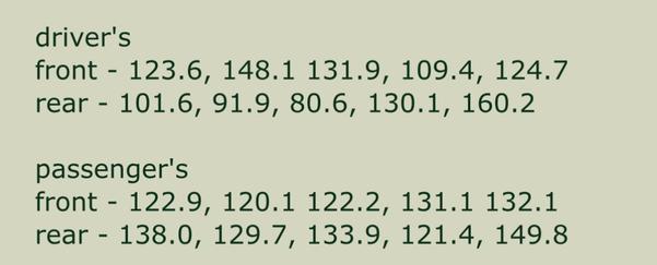

You can’t tell me these were all torqued to the same 95 ft/lbs.
That is a pretty wide disparity, and the ones that are very low or very high do look bad. Nevertheless, you have two misconceptions. First, it always takes more torque to initially break a fastener loose than what it was torqued to originally. This is because bolts actually stretch and pull back when tightened. A "torque-to-yield" fastener only does this one time; they are not supposed to be used a second time. Another factor is friction between the nut and wheel, as well as between the nut and stud threads. Cylinder head bolts, when installing, typically - if specified by the car maker - need a light lubrication on the threads as well as the underside of the bolt head, or both sides of the washer if one is used to reduce such friction and increase the stretching effect. This is not done with wheels (or spark plugs).
Second, maybe yours is different, but no manufacturer I have ever used, known or known about recommends using their torque wrenches, no matter the type, to break a fastener loose. What does the owner's manual say about this?
Posts: 32130 | Location: Johnson City, TN | Registered: April 28, 2012Reply With QuoteReport This Post
on some vehicles the specification does require lubrication as part of wheel assembly torque specification. Check for your vehicle.
Posts: 11928 | Registered: October 14, 2004Reply With QuoteReport This Post
I’m aware of that and at no point indicated otherwise.
The manual says what I said:
I bought a digital torque thing from Harbor Freight that’ll measure torque in either direction.
Harbor Freight digital torque adapter
I used the above on a breaker bar and did not exceed the digital torque adapter’s range. It’s a slick device with 50 memory spots. I just loosened every lugnut and it automatically saved the peak torque, in this case the torque required to break the nut loose, in a memory spot.
Those are your misconceptions, not mine. Razz
Clearly, the two Sam’s Club guys missed two lugnuts. I was half watching the first guy and thought I saw him only check three in that wheel. I figured no problem, that’s why they have the second guy checking. I watched the second guy closely and couldn’t believe that he only check three as well and knew at least one of them was one the first guy did not torque. I told them this and they dismissed it as not possible.
The other thing my chart shows is that even the ones that were torqued, they weren’t torqued to the same number. If they had been, then the amount of torque required to loosen them should have been about the same for all the lugnuts. More than what they were tightened to of course.
The front rotors on my Odyssey don’t like when the lug nuts are not torqued evenly. I replaced two sets of rotors until learned this, started torquing them myself, and haven’t had a problem since.
The main point being, torque your own lug nuts, it’s the only way to be sure.
Posts: 14975 | Location: SWFL | Registered: October 10, 2007Reply With QuoteReport This Post
