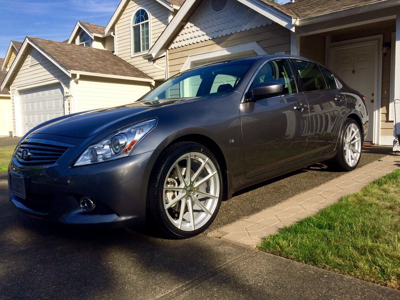

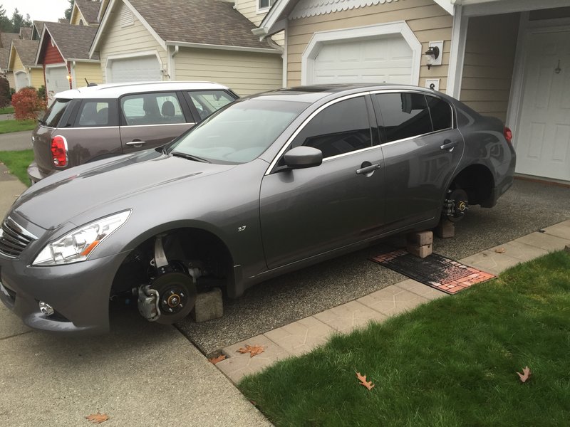

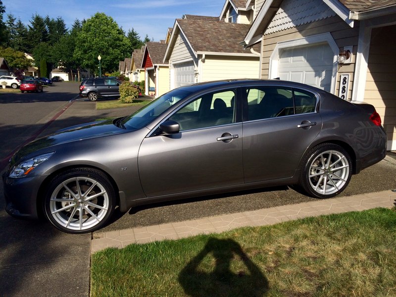

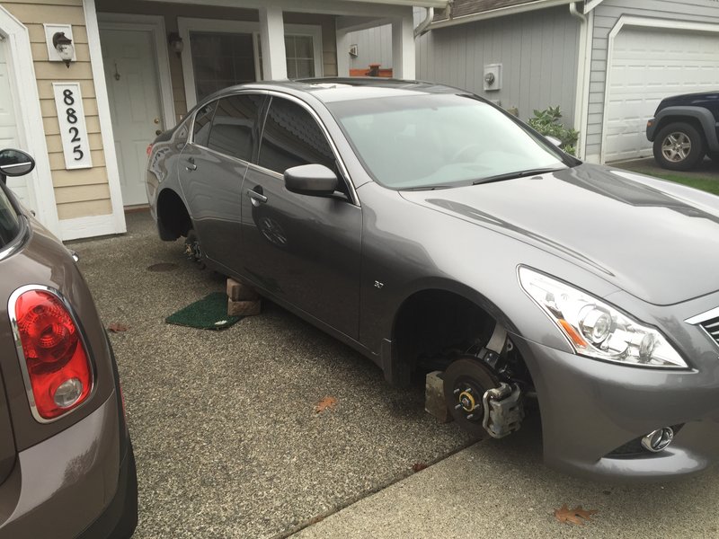

Picture of Beancooker
Locking lug nuts are pointless. They serve zero purpose. If you want to steal wheels, locking lugs do nothing to hamper the efforts of a thief.
To remove locking lugs, get a socket set with 12 point (or more) sockets. Find the socket that barely fits over the locking lug. Go down one size and tap it on with a hammer I say tap, but it’s more of a pound that shit on. Take a breaker bar and slowly loosen it. Do not use an impact gun. It’ll just shear off the edges.
That’s how the pieces of shit that steal wheels get around the locking lugs.
See pictures below.
