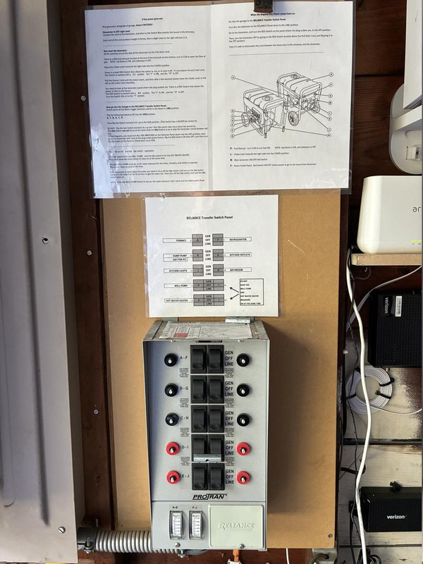

I’ve got a 3500 portable and just bought a 5k portable.
Back in 2010 I installed a Reliance Transfer Panel which supplies all the necessary items (no AC though).
There is a single plug on the outside of the house the generator plugs into as the feed.
I laminated directions for setup in case I wasn’t home and my wife or sons had to get it up and running.
We keep eight 5 gal gas cans out in the tractor shed that I rotate the fuel twice a year to keep it fresh and use fuel stabilizer.
We got hit hard in Oct 2012 by hurricane Sandy, lost power for 10 days. I had that generator chained to the bumper of my truck. After 4 or 5 days my neighbors noticed people “taking a walk” casually through the neighborhood. We didn’t recognize them, and we all agreed to open carry while outside to let strangers know we weren’t fucking around.
That generator setup saved us a lot of grief, and we had many neighbors coming over to warm up, have hot meals, and take hot showers.
