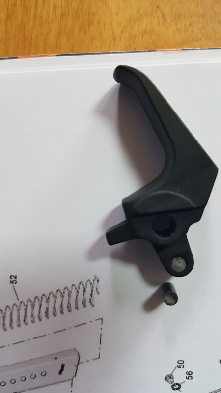

Haave not stripped it yet, trigger went dead during firing flops around as if disconnected from trigger bar. ?

Sounds like the trigger bar spring is either disengaged or broke. Easy to tell, remove the right grip panel.

It turns out that there is a trigger dowel pin in the trigger that connects with the trigger bar; not the usual pin that is part of the trigger bar. The dowel pin sheared off right where it enters the trigger. Sig has changed the internal design of the trigger and will have to make the repair with a replacement trigger at the factory. This is a part that should not fail, but they are taking care of it.

Wow. Unusual spot to break. Factory trigger or GGI?

Factory. Sig customer service tells me they have re-designed the trigger and that I need to send it to them for fitting. It looks like a defective part-I think I can see where it separated before it broke. I am going to miss the gun, it is my favorite.

The SAO trigger appears to be a MIM part. The new up coming GGI and Armory Craft SAO triggers are machined steel. After seen yours, I'll be careful with my SAO P226 until I can get my hands on a machined trigger.

That pin is pressed into the trigger, I wonder if they cracked it during assembly.

Got the gun back in 10 days door to door. Customer service was great. They installed a new trigger and I believe a new trigger bar. Looks like they really beefed up the connection between trigger and trigger bar.
