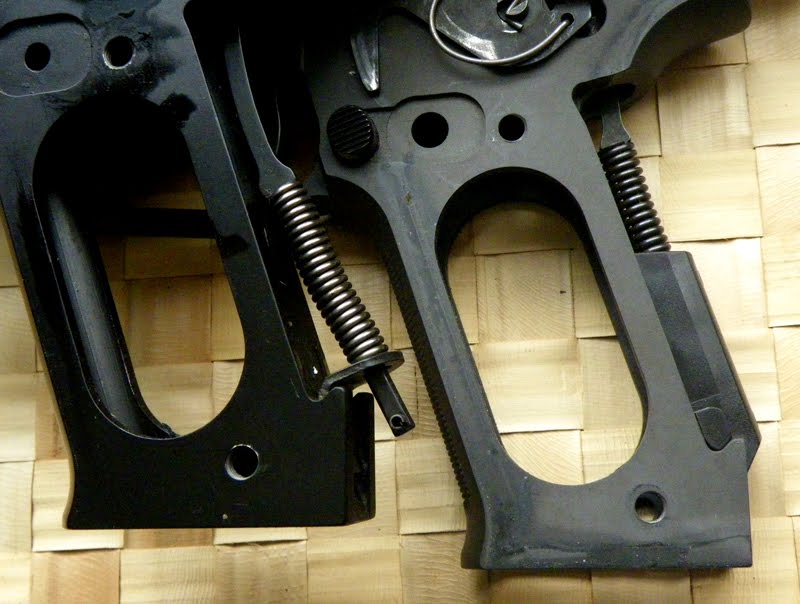

Can someone tell me what the functional difference would be between a P220 hammer spring for ser# below G219166 and one for a ser# above that? I ordered some spares from Wolff a while back and just noticed on the bags they are marked for ser# above G219166. Thanks

With the P220 and other classic P-series pistols, the difference is whether your gun has the old metal mainspring base or the newer plastic mainspring base. Mainsprings for the old guns are longer than those for the newer guns. That particular serial number often shows up, however, it may not be accurate.

Just in case you are unfamiliar with the different mainspring seats, here's an older metal seat and a long plastic seat (the E2-gripped pistols and some newer P-series have a shorter plastic seat).

Yeah now I remember how I got these. Was ordering them for my newer pistol like on the right in the pic and the guy on the phone at Wolff asked me something about the serial number and these are what I got (like the one on the left in the pic). Needless to say they didnt fit the newer pistol but I was wondering if they would work in my early 220's below serial# G219166 or if I needed to order ones labeled as that.

Forget the serial number and pull the grips off.
The seat and strut are what matters not the serial number.
I gave up long ago trying to keep up with what style is what. Now I look at what I have and go from there.
