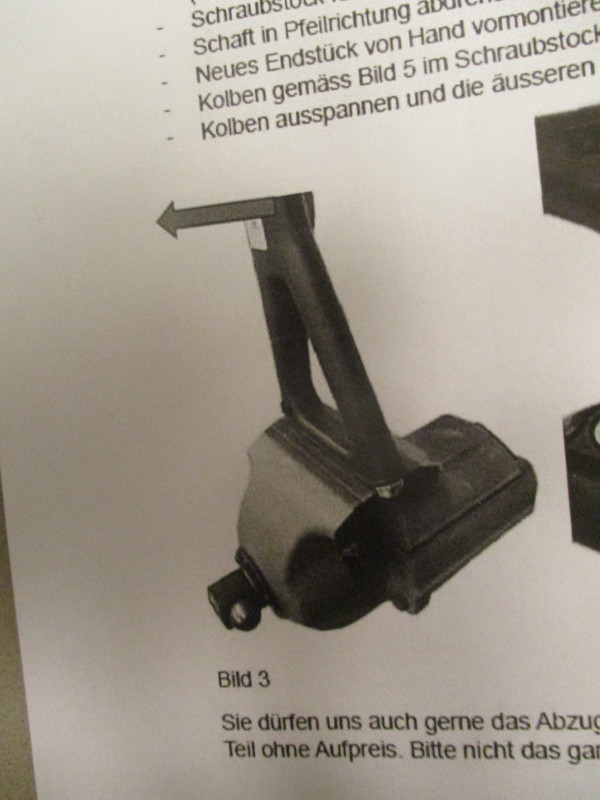

The rubber butt pad can be replaced. I did it. Place the butt pad in a vice. Be sure not to touch the plastic part. The straight part toward the rear of vice. Clamp tightly. Give the stock a quick slap in the direction of the arrow and it will detach. Place the new end-piece in the lower part of stock and gently tap with a rubber mallet. Takes about a minute and all done. This info came from a Sig 550/551 manual.
