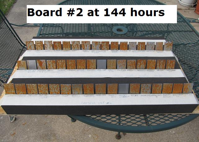

I bought a gallon of Boeshild to put on my boat occasionally. It works good to keep the salt from corroding it so badly. It was developed by Boeing to slap on their bare aluminum on the planes. Think about the price of an airplane and them landing them in salt environments like Honolulu, Seattle, San Francisco etc etc. That said, I started using either Eezox or Hornady one shot.
There's a lot of guys that have done tests, just google gun lube tests or rust or test plates. Here's what I'm talking about, but there's more out there of course:
http://www.6mmbr.com/corrosiontest.html
^^^ That one, fella took 46 different products that he bought himself, tried to follow exactly what the mfg said to do, then left them out in the weather. It's obvious some products work better. Boeshield T9 holds up well in the weather, but lubricity suffers. Hornady One Shot looked like a clear winner on another test, but checks out earlier here. But it all works. Good stuff: https://www.shootersforum.com/...duct-evaluation.html
Interesting that my grandfather never had rust on his guns and he had them out in weather frequently to hunt and target shoot and all he had was some ratty old oil. He'd wipe them down regularly.
Posts: 2076 | Location: Portland | Registered: August 01, 2012Reply With QuoteReport This Post
