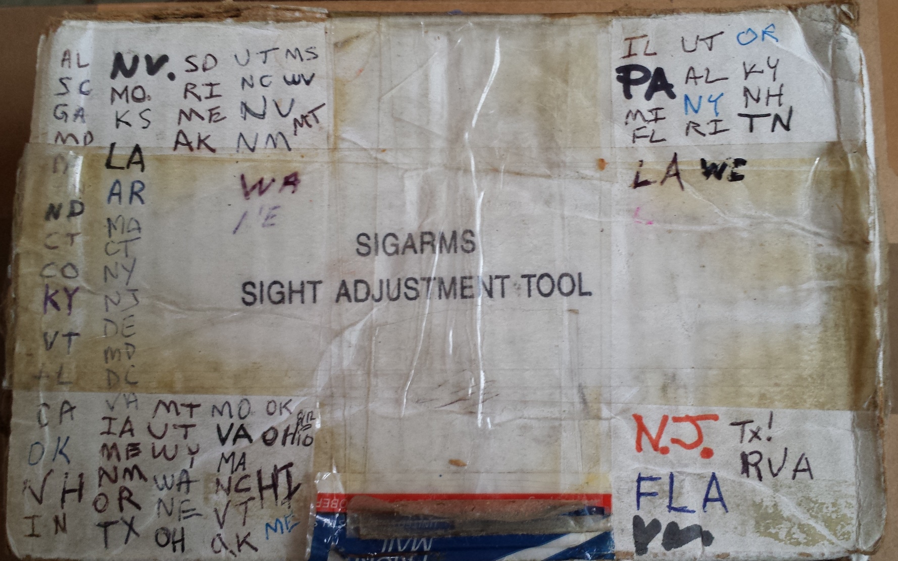

GaryBF nailed it, I've sent my sight pusher to almost every state, and the printed instructions I always include in the box say just that.
Not sure how the guy linked in the OP buggered up his sight/dovetail, but it wasn't from pushing a sight out the wrong direction.
