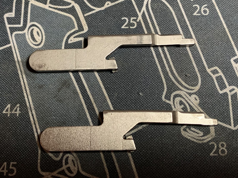

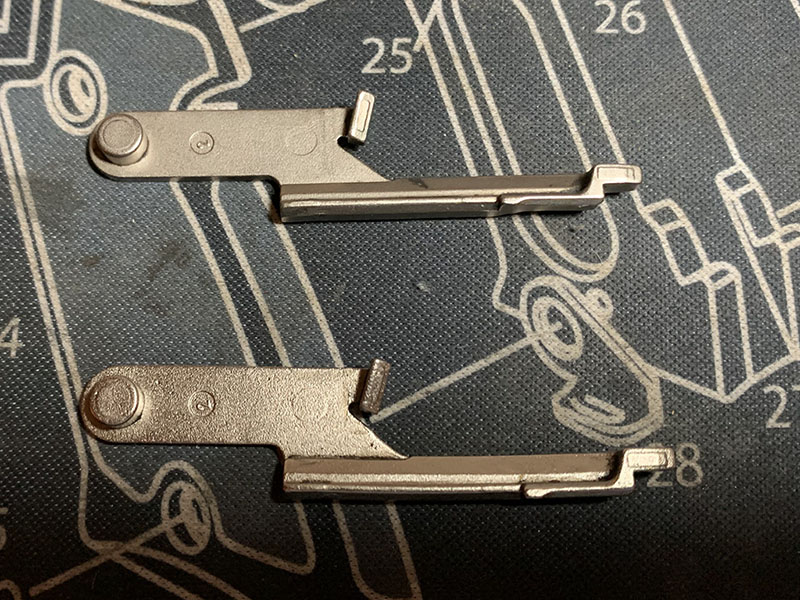

The new part arrived this morning. It is clearly still an MIM part, but also looks quite different from the original. Less "grainy" with sharper detail. I wouldn't normally care, but I hope this means it will also stand up better to the recoil. Here are some comparison photos, new part is the one on top:
It also fits much better in the frame. This is what I expected of course, but it's still good to know that I was able to correctly identify the problem.
All function checks are perfect, smooth as butter. It feels pretty much like the original did before firing, so that will be the real test I suppose. I haven't replaced the recoil spring yet. Whether or not I do so before firing depends on how long it takes the replacement to arrive. This certainly does lend credence to my theory that the gun was unfired, not just detail stripped and really carefully cleaned by the previous owner, which is a nice surprise if true.
I'll update after either replacing the spring or the next test fire, whatever comes first.
