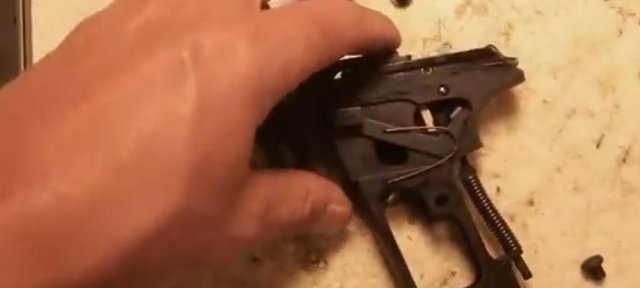

I went to replace the grips on my 232. Easy right? Nope. I accidentally knocked loose what I think is the decocker spring and not I can't figure out how to get it back in place. Any help much appreciated.
IMG_3812 by Keith Olin, on Flickr

At 3:30 mark shows spring.
Posts: 1949 | Location: New Mexico | Registered: March 21, 2017Reply With QuoteReport This Post
I think I got it from here, thanks Greyman. Just sits on top. I thought it was a more complicated routing.
