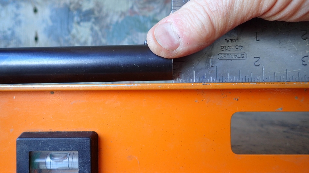

While simple storage of a longarm leaning in some way isn't going to bend the barrel, single barrel shotgun barrels are relatively easily bent and this can be used to advantage.
I have hole in one of my anvil stumps I use for zeroing shotguns. It is quite easy to do if one gets the hang of it. Many are the shotguns that do not shoot/pattern on the bead/rib/sights. Tweaking them in the direction you want the shot to go makes the shot go in the direction you tweaked!
Here's an example:
Amount tweaked:
The "fixture":
In use:
The Results:
40 meters {43 yards} and a handloaded round of buckshot.
