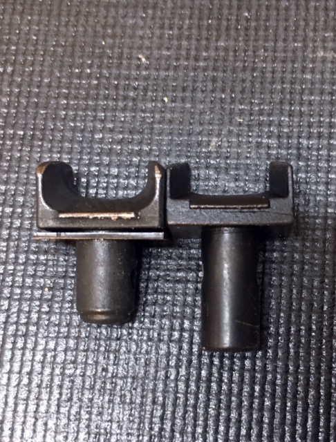

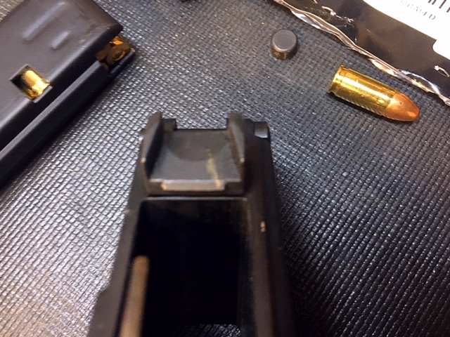

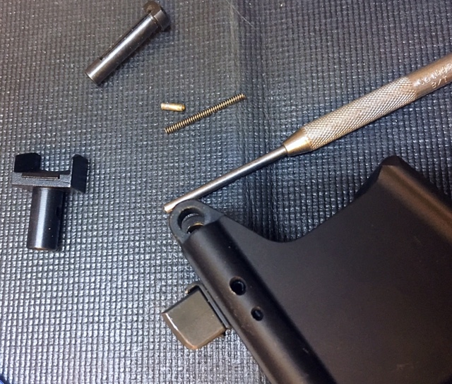

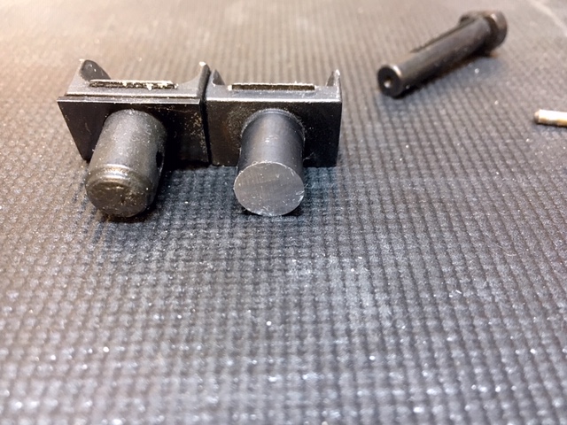

Is anyone aware of a company that sells just the feed ramp?
PSA sells the Glock style as a part but not the Colt style.
U.S.M.C.
VFW-8054
III%
April 04, 2019, 12:42 PM
tha1000

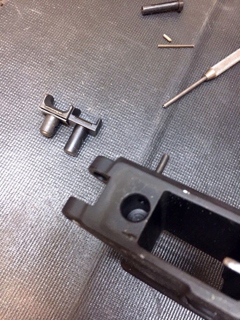

I've never seen a colt lower or mag block that doesn't have an integrated feed ramp... Glock pattern guns typically use the mag as a feed ramp. Taccom makes a drop in Glock feed ramp. They also make a ramped barrel that might suffice for your needs. Not sure how it works or if it works with a traditional colt feedramp setup.
Edit to add: Spikes has a few different variants of their feed ramp because the one that came with my lower interfered with the JP bolt I was using and they shipped me another. They might sell the ramps ala carte, I don't know. It is held in with a set screw that is behind the hinge pin on the front of their lower. I would suspect that all the feed ramps are similarly spec'd in terms of the holes in the lower... but I do not know for sure.
I'm all jacked up on Mountain Dew...
April 04, 2019, 08:42 PM
GrumpyBiker
PSAs Colt stick mag Lowers have feed ramps that are held in with roll pins & are removable.

tha1000
Ok. That’s probably going to be a proprietary part. Spikes feed ramp attaches in a completely different manner.
April 05, 2019, 06:25 AM
tha1000
Cmmg uses a roll pin. Not sure if it’s the same though ugh.
https://www.primaryarms.com/cm...mm-ar-rifles-90ca5ed
April 05, 2019, 07:15 AM

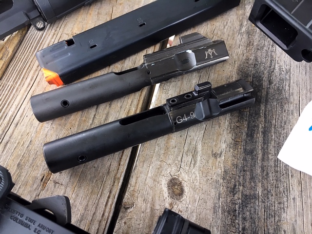

GrumpyBiker
Thank you for this.
I’d called Mas Defense and talked to their tech about the compatibility issue between the new Gen4 AR 9 & Mas Defense upper I ordered.
He said their BCG are rebadged CMMGs.
So this feed ramp may be the perfect swap for the new PSA lowers to side step their proprietary BCG & feed ramp.
For $35 there’s no reason not to just give it a try & see.
I’m hitting the range in a few hours.
Thanks again.

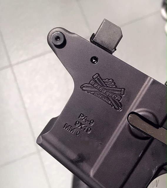

GrumpyBiker
I now have 15 ARs so it’s not really aggravating.
I’m kinda interested in this project.
I went ahead and bought another PSA lower and ordered their Gen4 BCG.
I took that to the range yesterday to see if those parts will run in the YHM barreled upper.
It ran perfectly, zero issues. And this little bugger is so easy to shoot accurately.
I was shooting at 15yrds as it’s a 4.75” barrel .
The feed ramp on the first PSA lower I bought that I altered to run with the CMMG BCG also ran perfectly with the Gen4 BCG.
But I’m now interested in seeing if installing the CMMG feed ramp will run correctly in the PSA lower.
I know I now have a reliable setup (400rds later) so at this point I’m just poking around with the first lower to see what can be made to work without being forced to go with PSAs proprietary complete uppers as I really don’t like the looks of the uppers they offer.
But I do wish the AR9 platform was standardized.

April 07, 2019, 08:56 PM
gw3971
Great and timely thread! I just ordered a palmetto state armory 9mm lower and I'm excited for the build. Thanks for all of the great info guys.

tha1000
After 1200 flawless rounds in class last weekend, my SBR crapped on 3 stages in yesterday's match. I had 80 seconds worth of malfunction clearing drills... bent the ejector in and it ran fine. But I have no idea how it went from running flawlessly to needing the ejector tuned.

GrumpyBiker

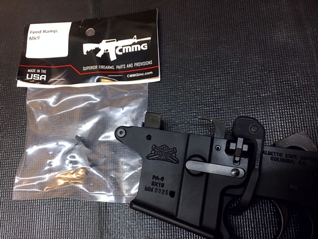

CMMG feed ramp arrived.
Hope to get out to the range soon.

Nice. I love it when a plan comes together!

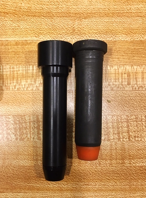

April 16, 2019, 06:18 AM

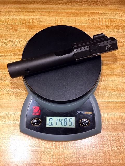

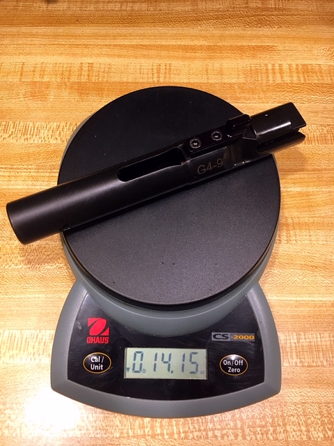

GrumpyBiker

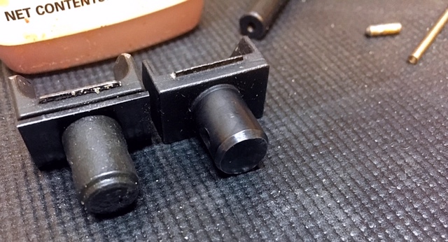

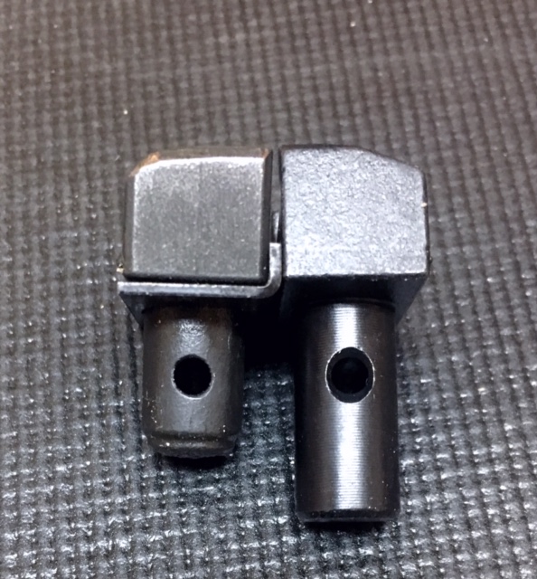

A little difference in weight between the CMMG style & PSAs BCG.
I wouldn’t think it’d be enough to effect the running of it but I’m not well versed in BCG weights to know.
Any opinions?
Also how do you think a heavy 9mm buffer would effect the running of this pistol?
Slow it down?
U.S.M.C.
VFW-8054
III%

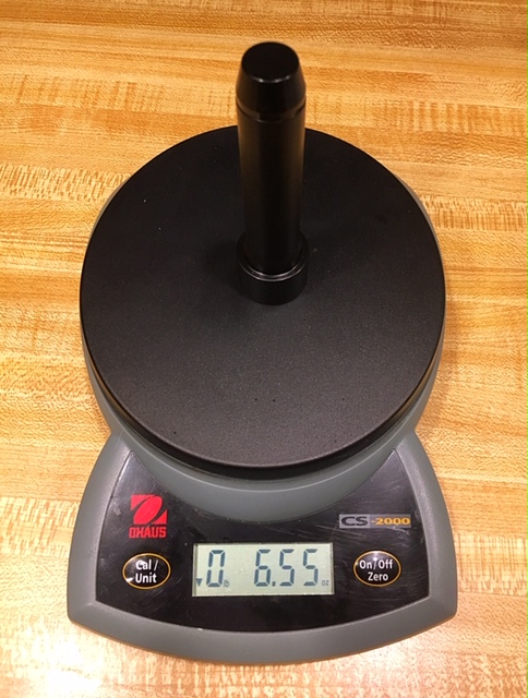

April 18, 2019, 06:31 PM
GrumpyBiker
The PSA Gen4 9mm lowers come with a heavier buffer (5.55oz).
I went ahead and ordered an FM9 heavy buffer (6.55oz).
I was a bit surprised to see the difference in over all length as well.
Is an HSS 5-5.5oz buffer the norm?

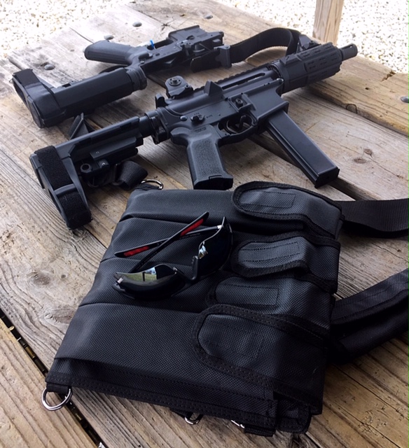

April 26, 2019, 03:10 PM

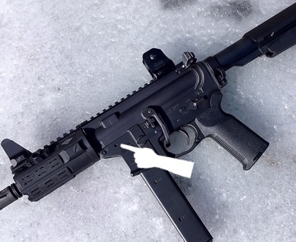

GrumpyBiker

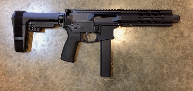

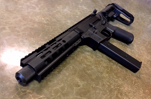

8” AR9 number two!
This message has been edited. Last edited by: GrumpyBiker,
U.S.M.C.
VFW-8054
III%
April 26, 2019, 03:53 PM
Rustpot
That looks really good. I've debated ordering the dedicated lower to convert my mag-block lower, but I'm not putting money into it, especially with the winter season shooting mostly steel being over.
What grip is that? It looks like a BCM, but not quite.
