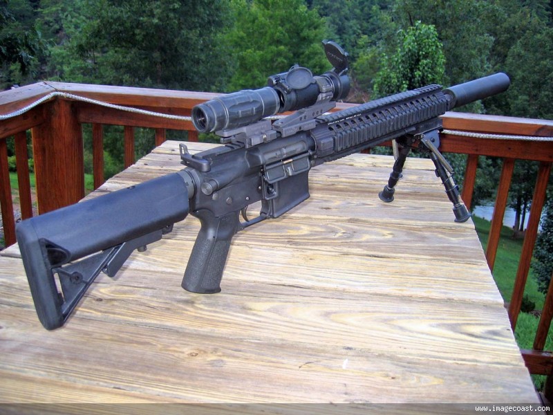

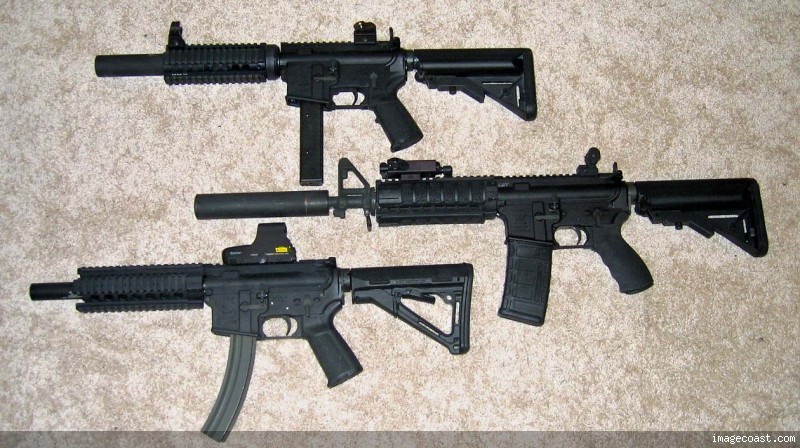

I have played around with 2 different setups for my ciener
14" AR with a GemTech 556 M496D. More accurate but you have to run more lube and take the suppressor off every couple hundred rounds to make sure it doesnt stick.
I also run a dedicated 22lr AR with a colt bbl cut down to 5". This setup runs great with no problems at all. Groups well enough to shoot cans all day and lots of fun but you would need an SBR stamp. (bottom rifle)
Either way its lots of fun and cheap to shoot. Good luck!

Can you please tell us the specifics of the 22? Did the upper come as a unit, or did you build it? Which 22 adapter/mag did you use?
What about the 9mm setup?

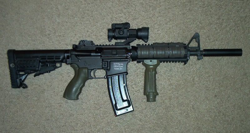

Yep, I am running a Ciener kit in my 10.3" CMMG SBR with a Outback II suppressor attached. Is it fun? Hell yes! Is it accurate? Not bad at 50 yards (plate sized groups with open sights). Is it perfect? Nope. You have to keep it clean and very well lubed. Mine only functions 90% with hot ammo, and even then it jams sometimes. Can I live with it? Yes. I won't ever use it to defend my life, its for targets, cans and squirrels with attitudes. I highly recommend it.
Cheers!
Oh, BTW - this setup is VERY quiet. Sound is less than a pellet-gun with subsonic ammo.
