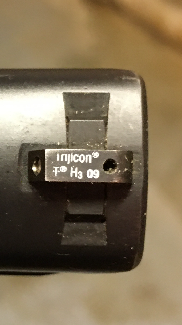

You had me wondering so I pulled out my 229 in .357 that I bought new in November 1995. I had the dimming sights replaced by SIG and here are closeups of the new what appear to be #9 front & rear sights. That is unless that was the year of the replacement sights?

H3 is the chemical symbol for tritium, 09 is the date of manufacture. The size is stamped into the sight but never painted, in my experience.

If Sig made a #3 front it would be 0.245" tall.
A #9 rear would be 0.260" tall.
Some are stamped some are not on the older ones.
You have to measure them to get the size.
Thanks!
